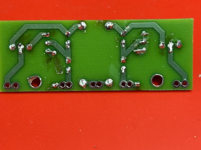

What does the bottom of the small board look like?

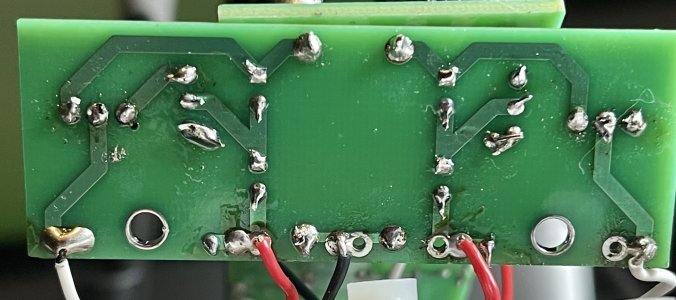

I attach a photo of the SB bottom.

Reply #3 on: August 29, 2022, 04:31:12 AM
Are you using lead free solder by chance?  How hot of an iron?

Cesáreo Ruiz
Reply #5 on: August 29, 2022, 05:39:56 AM
I would turn it up to max temp.  Your solder isn't getting hot enough.  You probably don't need to reflow the joints for the LEDs, but I would reflow the resistor and transistor solder joints at max temp.

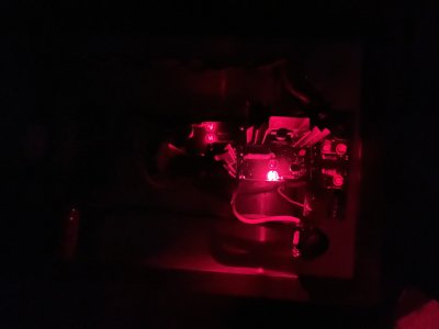

I checked the LEDs with the diode setting on the multimeter. Some of them show a small voltage and bip, others show no voltage but light up when tested. Infinite resistance when tested backwards. I attach a picture of them on the powered circuit.

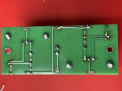

As you suggested, I installed a new small board, soldered with the iron at max temperature (pics. attached). I'm now getting low voltages on IA and IB:
