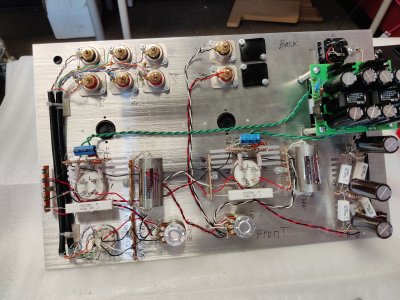

Hello all, I just finished my standard BeePre build and got it working with no issues.  The manual was very well done and clearly explained every step, I'd say it took me around 20 hours total to finish the kit.  As an added upgrade I used VCAP ODAM instead of the Dayton Audio output caps.  So far it sounds very good with no notable buzz or hum, and I'm using my used pair of Takatsuki 300Bs in it.  My questions relate to the balance pot.  Is it possible to bypass it, and are there any negatives to doing so? I notice that there are the two resistors on it which seem to be in parallel with the pot, what is the function of those?  I assume if one simply jumped over them with wire they would bypass the balance pot, but I don't want to do so without knowing if that will hurt anything.  I've never used balance controls on any of my gear and would ideally remove it from the signal path if possible.

Without those resistors, the output voltage when centered is -6dB on both channels. With the resistors added, it's -3dB (half power) when centered. Thus the total power (both channels) is constant when adjusting the balance.
They can be bypassed by removing the resistors and taking the output from the hot terminal, leaving no connection to the wiper. That leaves the control's end-to-end resistance as a grid-to-ground resistor but eliminates the wiper contact.

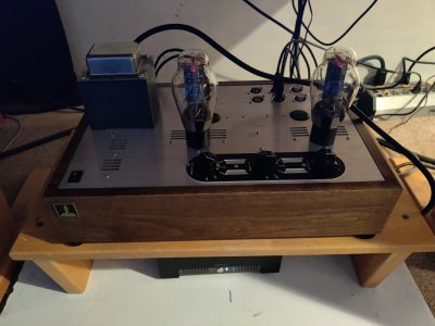

Bee2Quiet Upgrade installed and working.  Great upgrade, I'd say it took me about 6-7 hours to install and it significantly improved the preamp.  Better resolution, perfect channel balance, the sound seems more refined, and it looks nice with the new face plate under the knobs.  Thanks for the recommendations.  Next up I might build the Kaiju to go with this at some point.
