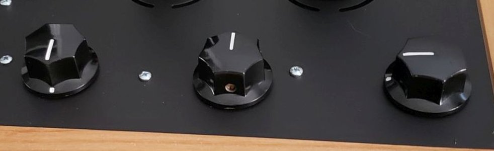

Maybe I'm dense, but I can't seem to get the knob on the source selector to seat fully and it sticks up higher than the others, and has an 1/8" gap between it and the chassis. is this normal for this kit?

Re: Source selector knob too high?
September 09, 2022, 10:30:59 AM
You can move the other knobs up 1/8" or cut the shaft of the selector switch down slightly.
September 09, 2022, 11:09:44 AM
Yeah, I looked at it a bit more and the problem is that the rotary switch has a different base that doesn't allow the knob to go down to the chassis. I guess it is what it is ¯\_(ツ)_/¯

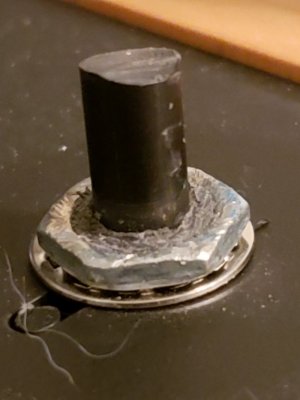

Mine was a two part solution.
1. Cut off an 1/8 inch of the shaft.
2. Cut off all plastic above the mounting nut. Making it flush with the nut is perfect. I used a hacksaw blade (bare blade removed from saw) and took my time being careful not to cut into the shaft as I worked around it.
The trick is getting rid of the plastic above the nut or the knob will never mount flush. Going to a different style of knob could work as well but the BH supplied ones will not mount flush without modification.
