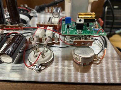

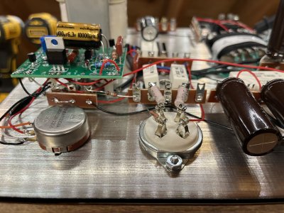

Hi,
I’m working my way through my Kaiju build and am running into issues with the voltages on 32U and 46U.
On the A socket board:
  • IA: 506v
  • OA: 302v
  • 32u: 3.9mv
On the B socket board:
  • IA: 506v
  • OA: 307v
  • 32u: 16.3mv
Turning neither pot changes 32U/46U significantly.
I did noticed that it looks like neither LED in D2 on the B sides of the boards is lit.
I tried reflowing everything on the two boards, which made no difference. Can you recommend next steps for troubleshooting?
Thank you for you help!
Offline dehringer
    • Posts: 31
Reply #1 on: September 09, 2022, 03:03:00 PM

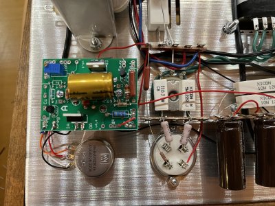

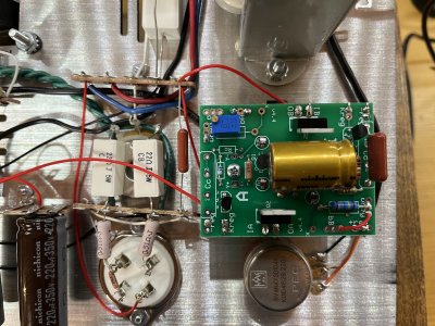

Additional pictures of the other side.
    • Posts: 20290
Reply #2 on: September 09, 2022, 03:33:27 PM
All your 431 regulators are installed backwards.  You have also left off a resistor on each board.
The resistor going to pin 3 on one of your 4 pin sockets appears to be very close to pin 4.  Keep in mind that if they touch, you will likely damage the 300B tube plugged into that socket.
