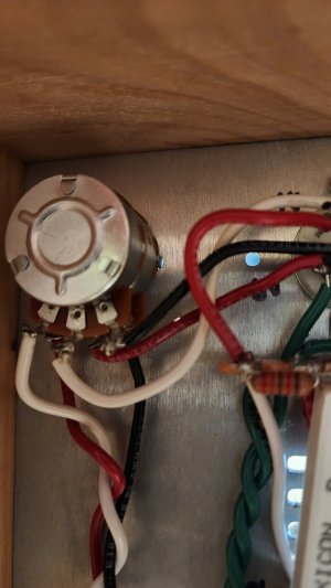

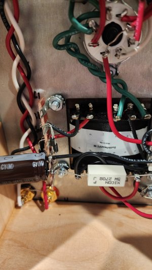

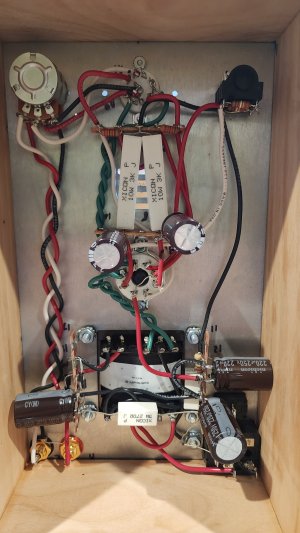

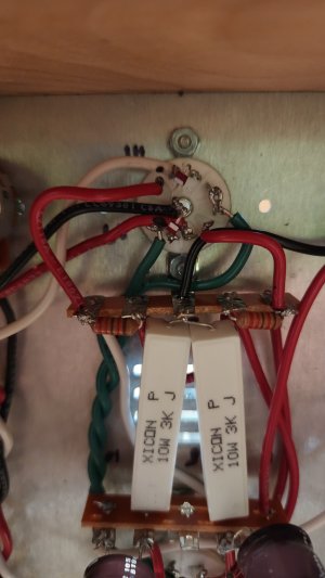

Here are the pictures:
    • Posts: 9790
Reply #2 on: September 18, 2022, 11:33:04 AM
You are missing the black wire from the volume pot terminal to the center terminal of the strip right behind the nine pin socket.

Reply #3 on: September 18, 2022, 11:37:15 AM
Wow, no idea how I missed a darn step, but thank you Doc!  I'll post an update once I correct this!
