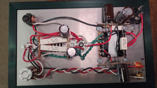

So, before I go back and work on reflow and things, I wanted to ask a couple of more questions.
1.  When checking the resistance on the RCA jacks I was getting the correct within spec reading when I would touch the black probe to the left jack and the red probe to the right jack.  I know I should use probes with alligator clips, but that is not what I own.  Instead I used a spare alligator clip to attach the black probe to the 12U in order to keep that there during the rest of the tests as to not shock myself or cause harm (1 hand free).  I understood all checks until I got to the RCA part simply because leaving a probe on 12U and then touching the red to either jack did nothing.  It only worked once I did what I mentioned above, just making sure I was correct on that before I go and do the next round of tests!  So if the RCA resistance check can be explained by someone I would appreciate that.

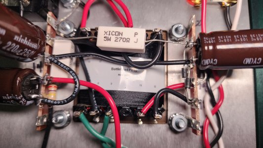

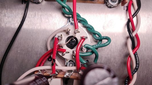

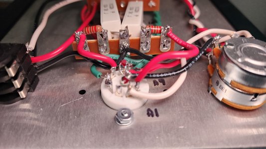

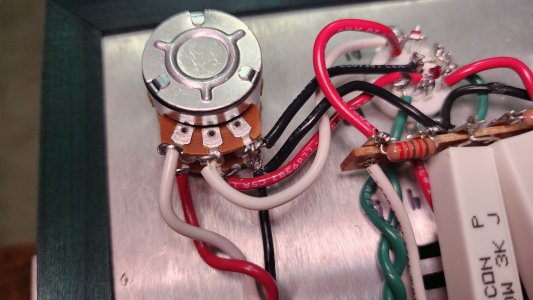

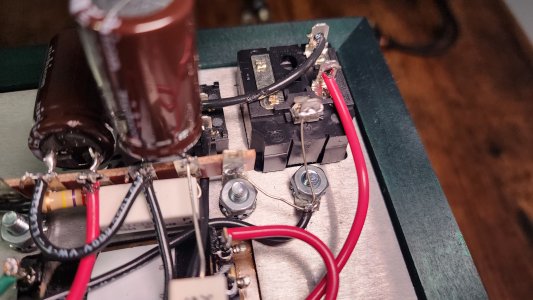

2.  When I reflow soldered joints, is it typically a good idea in this case, with this type of project, to simply reheat the solder already there as I have seen others do?  I don't want to add in more solder if it will just bubble it all up too much.  I also tried using the copper wick for removing and proved to be a bit difficult working with the different parts of the amp (I had just 1 solder during my build that I had to remove some from and redo the joint).  You'll see the capacitor at 14U/15U had to be resoldered as I had originally put it in 13/14U!

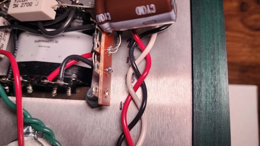

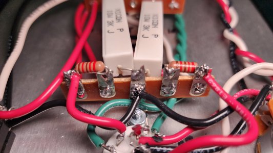

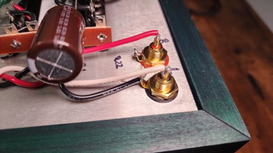

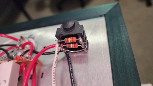

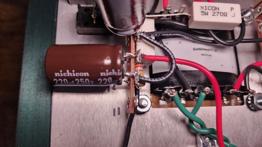

I am posting pictures on my next reply that I just took.  These are much closer in pictures and lit up better so they can be seen well enough.  Beings I am very much a novice, I am hoping some errors could be spotted...or hell maybe I did a decent job and its simply a couple of loose wires as stated!  I'm definitely going to check the left RCA jack but I'm not quite sure how to fix either RCA jack if that is the issue as soldering those were probably my biggest challenge since attaching to the cups was not as simple as the rest.  Perhaps I need to just order new RCA jacks and do that over...though I'd rather not.
Alright, pictures incoming and again, thank you everyone!

    • Posts: 9790
Reply #8 on: September 19, 2022, 05:45:31 PM
I'd be inclined to carefully reheat all of the connections on the headphone jack. Just enough to get them to flow out, you don't want to damage the plastic. Some of the resistor connections there look a little suspect. If they were not making good contact at startup because of a bad joint they might have made contact as the headphone plug was in and moving around a little, which could cause a pop just like the black wire connection closest to the chassis can. Left channel would be the resistor farthest from the chassis, connected to the white wire.
    • Posts: 20297
Reply #9 on: September 20, 2022, 04:12:18 AM
This would be consistent with the missing wire that you had.
Do you have a loose black wire on the headphone jack?  If you wiggle the one that runs across the bottom row of terminals on the jack, is it well captured by solder or does it wiggle around?

Reply #10 on: September 20, 2022, 09:12:53 AM
Thank you Doc and Paul!  I will check that black wire and touch up my soldering tonight on the headphone jack then retest the RCA resistance.  I'm guessing if the resistance still doesn't read, then it could be my wires going into the RCA aren't getting a solid connection.  I did notice last night that left channel RCA had a slight wiggle to it but right RCA was firm.

Reply #12 on: September 20, 2022, 02:11:57 PM
Ok, I reflowed the joints around the headphone jack.  I did add a bit of solder to the black wires that connect as well as the top white wire (I also crimped the bit of wire poking out you see in the pictures).  I also checked the rca posts and reflowed those carefully as to not heat too much.  I do get a little wiggle on the Right RCA (not much) but that was not the channel I had the problem with.
Then I did all resistance checks again.  All of them passed.  I even tested out the RCA jacks again while having the black probe to the 12U and this time I got readings!  The left jack was a bit higher then the right (should have wrote them down but I believe left was 108 and right was 95.6 ) both still within the specs.

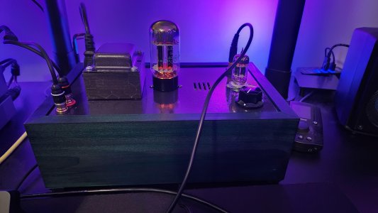

Offline skeeb234
    • Posts: 14
Reply #14 on: September 23, 2022, 12:42:13 PM
Oh, and a picture!
