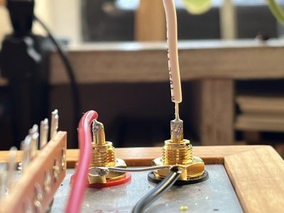

Hi! I'm back with another newbie question. Do I have too much bare wire peeking out above the black RCA jack (see photo)? I'm pretty sure the white wire is touching the bottom of the cup--I just stripped a little too much. Am I okay to go ahead and braid the wires, or is that bit of excess bare wire going to create problems down the road? Am I better trimming the white wire a bit and resoldering?

This isn't an issue in this part of the circuit.  The place where I commonly see this and it is an issue is the green wire going to A4/A5, as removing too much jacket can allow the bare wire to touch the chassis plate.

Thanks so much, Paul. I'll push forward, then.
