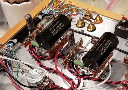

Offline Mucker
    • Posts: 397
Reply #8 on: October 19, 2022, 05:18:33 PM
The little 150uF cap could be replaced with something else, and that cap is very much in the signal path.  220uF/16V is a reasonable alternative value that's probably more commonly found.
I just replaced the stock caps with what you suggested above and could swear it did in fact make a noticeable difference. The caps were swapped with Elna RFS SILMIC II. Very smooth and sweet cap. Thanks for the suggestion PB!

Great feedback, thank you! I must however admit I am electrically illiterate  :-*

Reply #12 on: October 20, 2022, 06:55:11 AM
Thank you for the info. I am going to sit on the Silmic II for a while as the sole change. I wasn't expecting as big of change that I am hearing. Pretty amazing.
