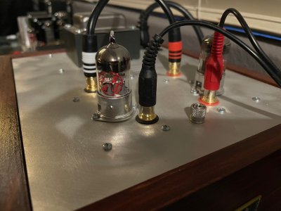

After building up the Moreplay, has anyone ever disassembled the preamp to paint the chassis? If so, how was the disassembly/reassembly of the preamp?
The chassis has no surface finish (no circular brush finish), and I'd like to add something to it. I've a feeling its not worth the effort but thought I'd ask.

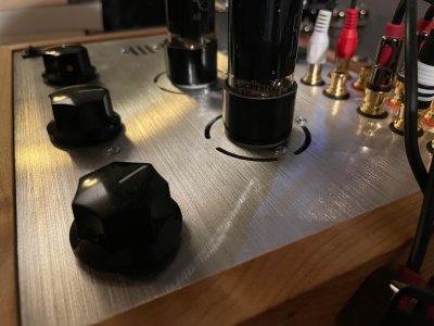

Just to clarify when you say the surface has no finish - it has a straight grained finish on top, yes? That's the finish I put on the panels these days instead of the random brushed finish. I grain the panels with a drum sander, as I am no longer able to do the random finish with a wire brush in an angle grinder. It's quite unlikely that a panel would have been sent out with no graining at all on the top side, but I want to make sure.

Reply #2 on: September 30, 2022, 03:28:19 PM
It could be me, but it appears to have no finish; it looks like raw stock finish. When compared to my Reduction, it is different.

Reply #3 on: September 30, 2022, 03:31:44 PM
That is a straight grain finish.  I would definitely not try to disassemble an amp to paint the top plate.  A clean stock built kit is often pretty easy to sell, and it would definitely be easier to start over with a fresh chassis plate and parts.
