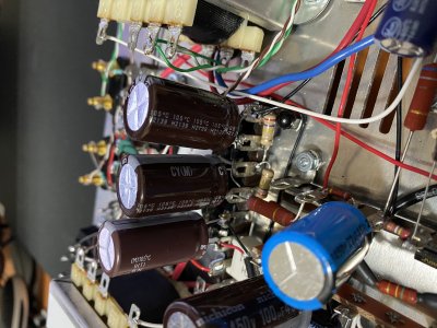

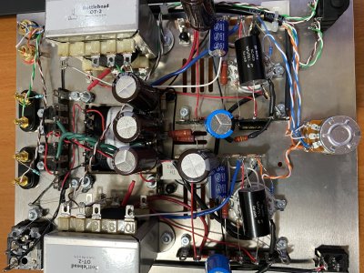

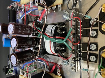

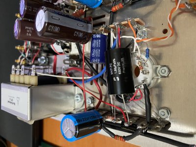

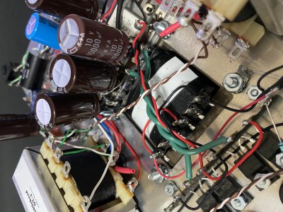

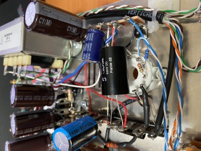

Attached are some photos of my build. Please let me know if there is any particular area I should be focusing on. Thanks!

A few things you can check while waiting for PB and Doc B to get back with you. Do you have enough solder on the MBRF745 diodes (H2L to H7L)? There isn't a good camera angle that shows this area clearly. These diodes rectify the DC for the heaters. You also might want to check the connections on the 5W resistor on 30L and 31L.

I double checked the connections you mentioned and noticed 30L has enough solder but it's broken off though. When I pushed the 5W resistor a bit, I could see the pin and the solder moving away from the plate!
I soldered 30L again and it's working again now :) Thanks everyone for your help. Much appreciated!
