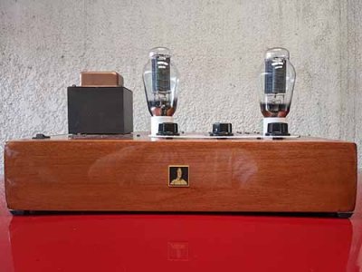

The basic Beepre 2 is singing nicely, works well even with my Class D DIY Purifi power amp. The last problem I encountered was the right speaker on channel 1 was not working, fixed it after simple trouble shooting.  I just have two questions left for the basic Beepre 2.
1. The knobs for changing the channels, balance control is kinda slipping. turning the control without the black colored knobs is easier, I've tightened the screws but it some how does not have a bite to it. Do I just have to tighten it more?  I'm worried might break it, also will be working with the upgrades by December which would require me to unscrew it again.  Is there an easy work around to this?
2. I already have the two upgrades with me.  But looking at the 2nd upgrade kit, it comes with 6CM7 tubes.  I think it is a rare tube (I'm in Asia).  Are there any compatible tubes with different numbering on it?  Russian, Japanese or Chinese tubes are easier to come by here.
I really enjoyed the product!
Kudos to the Bottlehead Team!  I'll promote you guys to the my audiophile friends here.  They just have to overcome the fear of using the soldering station.  But after my experience of a resistor going up in smokes and able to finish the kit, will encourage them on taking the path I took.  I'll audition my kit with them once I finish all the upgrades.  Hope they will  be impress, they have really expensive gear, but I'm confident my Beepre 2 can go toe to toe with their gear.

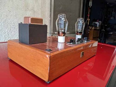

That finish is shiny! Congrats!

Thanks for the complement, working on the wood is harder than the electronics.

I completely agree. It's taken me 4 builds to feel even marginally comfortable on the wood finishing. I use water based polycrylic. Unforgiving stuff!
