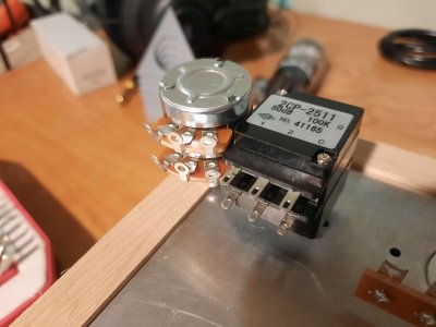

When I bought my Crack, I also invested in a TKD 2CP-2511 pot to hit the ground running with upgrades. I've attached a photo of it next to the potentiometer provided with the Crack kit for comparison.
So they look similar, in that they both have two rows of three contacts each. Question is, are the same contacts in the same places? Or will I have to connect the TKD pot differently than the instructions say for the stock pot?

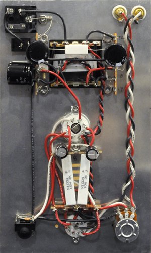

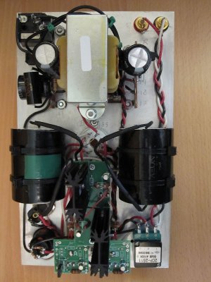

Hi there, yes, that's standard wiring for these volume pots.
For some reassurance, here attached are some photos from my files (I collect photos of other builds lol) showing the wiring is the same between both pots. Take your time and do your best! Cheers! :)
