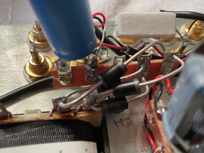

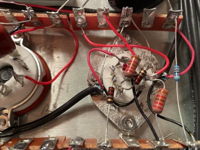

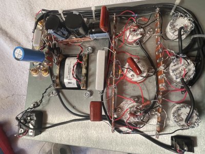

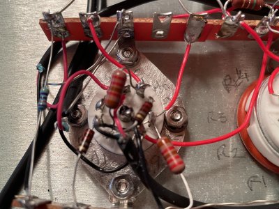

I would recommend posting some photos of your build.
Offline binayak
    • Posts: 6
Reply #2 on: October 31, 2022, 11:47:27 AM
Pics below.
    • Posts: 20286
Reply #3 on: October 31, 2022, 02:25:51 PM
The shielded twisted pair wiring that goes to pins A4/5/9 and B4/5/9 is not properly implemented and is likely to cause problems down the road, especially on the A socket.  This is clearly shown on page 22 of the manual.   The 120V wiring that goes from the IEC entry module to the power switch also should be placed in the spot that it's shown in the manual, not where you have it, otherwise you may create noise issues that wouldn't otherwise be there.
What are the voltages at pins A1 and B1?  If these voltages are more like 150V rather than 75V, the problem you have is likely cold solder joints and/or a missing jumper on the H terminal strips.

The 12AU7s are probably not glowing.
Offline binayak
    • Posts: 6
Reply #6 on: October 31, 2022, 05:19:22 PM
You were spot on, I had missed the step where you short the H terminals. (embarassing!). Now it measures spot on and sounds terrific! THANKS for supporting a kit that I bought ten years ago.
