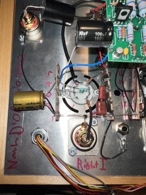

 Hi,
All the resistances were good. Voltages were fine for everything except the O-connections okc and okd had voltages of 2.24 vdc and 2.3 vdc. The rest had very low or something that couldn’t be picked up on my meter.
Any ideas?
Thanks in advance
a&s

Well one side is working perfectly.  I suspect on the non working side that there's either an issue with a solder bridge or cold/missing solder on the bottom of the board, or a miswire on the sockets.

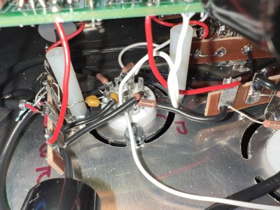

I have resoldered a bunch of the bridges, tabs, etc., and checked the wiring and am not finding any errors. Am I missing anything?

You either aren't using a soldering iron that's hot enough or you aren't holding it on your joints long enough to flow out, possibly both.

I got it working! Thanks for your insight. It ended up being a resistor that needed reflow on the board. Additionally, my last post about the tab in the other voltage test is reading totally fine now with the hold circuit wired up.
