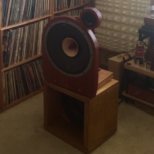

The Lii F-15s are the speakers I've been using for about three years now.  I use them in open baffle configuration.  They sound excellent to me, though they don't do deep bass and the top peters out above 10K (but so do my ears).  Frequency response is nowhere near flat but I find them extremely musical.
With a big baffle, they sound just fine, but I ended up using them in a small baffle as part of a three-way system:
My Kaiju has more than enough power (subs have their own amps).  I doubt the F-15 is a true 99 dB speaker, but they are efficient.

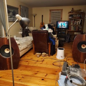

A friend has a second pair I bought on long-term loan and he listens to them (in bigger baffles I fashioned after Caintuck Audio's Betsy baffles) with both a 2A3 and 45 amps.

Thanks Larry, those look great . What are you doing for the tweeter, and for a crossover?

The point of the tweeter is to help out both the F-15s' and my ears' falling treble; anyone with good hearing might well run shrieking from the room.  It's a B&C DE35, used as a kind of "super tweeter" designed to augment the frequencies where my ears and the F-15s get a little shy:  8000 Hz and above.
The crossover is a 1uF capacitor.  Those with better hearing would no doubt use a smaller value and perhaps a resistor to knock it down a dB or two.  But it works well for me.
