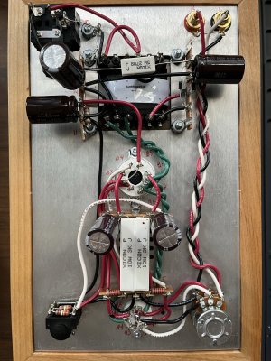

Hi, forum friends. Thought I'd check in to report that after many missteps and much neurosis, I at last finished building my Crack. On first listen, I was mainly just astonished that something I had built with my own two hands could actually play music without any obvious flaws. But as I listened more, something didn't sound right: compared to my Schiit stack, the amp sounded thin and strident; voices came across as artificial and just wrong. My fortunes turned when I found a relevant post on this forum in which Paul advised reflowing all the solder joints. Well, damn if that didn't work. My Crack was utterly transformed. Now I sit listening for hours in a state of sheer bliss, absolutely blown away by the way the amp brings my HD6XX to life.

I've included a photo of my build in case anyone here has any constructive criticism or sees any red flags. (I'm particularly curious  whether the lack of space between the 10W resistors is likely to become a problem.)

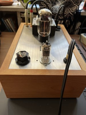

Congrats on getting it sorted - enjoy the BH magic. Pics of the top side?

Thanks Paul and Karl! Yes, I'm enjoying the BH magic tremendously--still amazed that after all my blundering I'm actually getting a taste of it. This being my first experience with tubes, I'm having a ton of fun getting acquainted with the amp. Today's learning: warm-up time--lots of it, with music fed through the amp--can make quite an audible difference!
