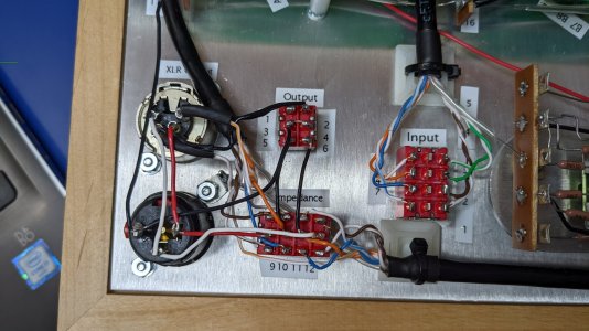

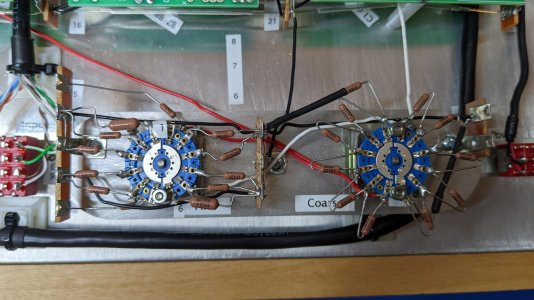

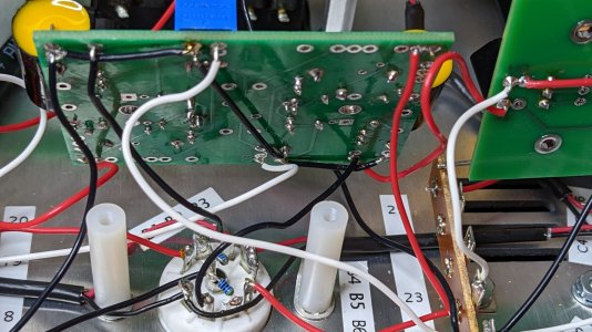

When you say trace the signal, I am assuming from RCA in through to the switches and then to the output jack posts... Correct?

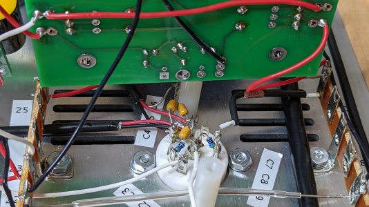

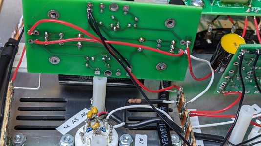

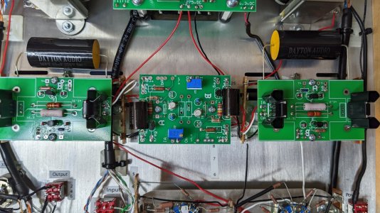

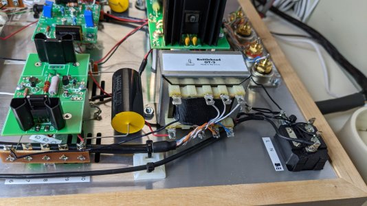

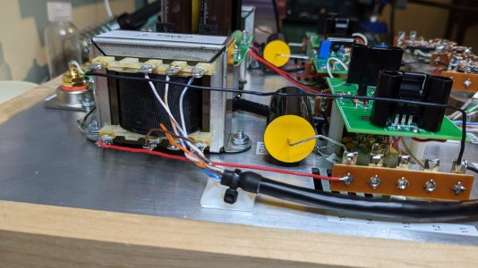

Photos attached. Let me know if you need some zooms.
Thanks as I have retraced most wiring build steps, shorts with 25x work lamp and looked at my solder joints over. I have also measured voltages out of the transistors (tracing the kreg voltage previously) which are consistent across all four.

Find an old phone or tablet with a headphone jack and use an 1/8" to RCA adapter cable and a tone generator amp to play 60Hz into the amp with the volume on the device all the way up.  You can do this initially with the amp powered off to test the input wiring.
With the black meter lead attached to terminal 7, you should be able to measure the AC signal voltage on the RCA jack pins, and that same voltage on each end of each red and white wire leaving the input selector toggle switch.  This would be the first step!

OMG...  :-[  :-[ I can't believe the schoolboy mistake & excuse I have for you Paul... It became very obvious as I put the tone signal signal on and walked the wire that there were no center wires on the Input switch!
Page 55 was "stuck" with a sticky glue thing perhaps from shipping material or something... never noticed while flipping pages in the wire check that I had missed the 4 center pin wires. oops... Kinda explains no sound since it had nowhere to go.
Everything is up an running! Thank you so much for the pointers.
