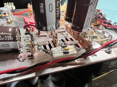

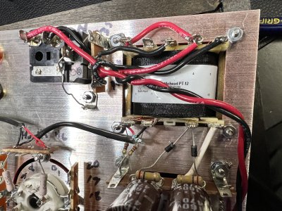

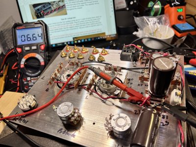

Now I have made it half way I guess .Getting 8 volts. Checked he wiring , cant figure it out .

It looks like one of the two diodes attached to the power transformer at terminal 9 is installed backwards. Check your manual for the correct configuration.
Reply #2 on: November 23, 2022, 04:23:40 AM
Along with the backwards diode, the red wire going to terminal 4 of the power transformer looks like it might be loose, as does the bus wire on the earth tab of the IEC jack.
For the STP wiring leaving power transformer terminals 6 and 7, if the shield foil sticking out touches one of the 220 ohm resistor leads going to terminal 6 or 7 on the power transformer, that can damage your power transformer.

Mucker Thank you!!!
One diode backwards did the trick.
