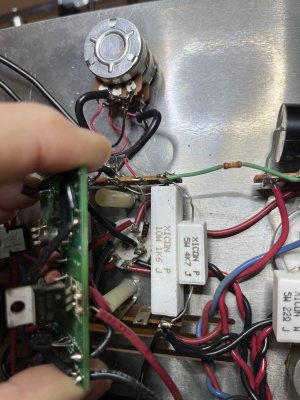

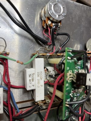

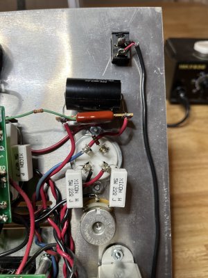

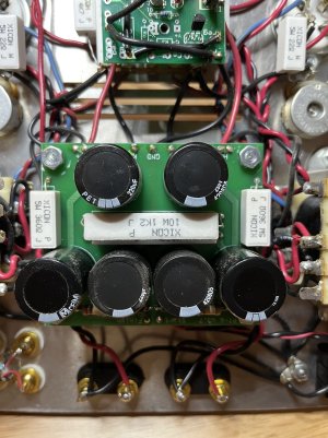

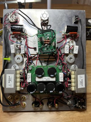

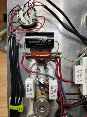

I think it would help to see some build pics.  The 2.5V and high output voltage from the C4S could possibly come from a cold solder joint on the middle leg of an MJE5731A, but this issue seems unlikely.  The grid stoppers being slightly different isn't a problem.

Reply #11 on: December 06, 2022, 03:29:43 PM
Paul,
Thanks for the continued support. Please find requested attached pictures. If you something more specific, please let me know.
Cheers
Bob S
Online Paul Birkeland
    • Posts: 20213
Reply #12 on: December 06, 2022, 03:45:04 PM
I would be extremely suspicious of the lower terminal solder joint where the shielded twisted pair drain wire lands.  This would be terminal 8L.
If one of the grids is floating relative to ground, that will give you weird voltages like you have.
