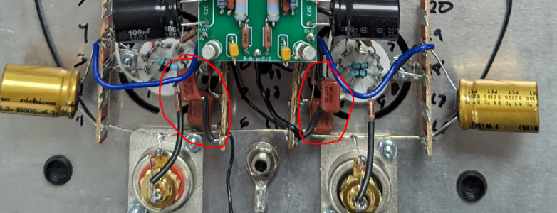

So, one of these (see attached image)?

If I messed with the output cap, could that have caused this?

To be clear the EQ circuit caps are just those red/orange ones I circled which are soldered to the posts between the EF86 tubes?
    • Posts: 20343
Reply #6 on: November 30, 2022, 06:29:33 AM
The 0.01uF and 0.030uF caps and the 10.5K resistor close by.
