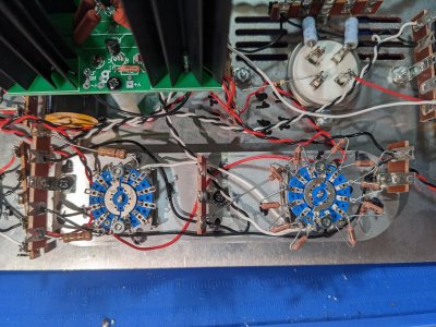

I would very, very, very strongly suggest posting photos of your wiring before attempting any reflowing of solder joints or anything like that.  A problem like this is either a miswire that needs to be corrected or a measuring issue with the meter (unlikely since you got the correct measurement on one side).
It's completely possible that there's an issue with one side of the fine attenuator that's actually causing this problem.
If you attempt to reflow your solder joints to get this issue to go away, more than likely you'll melt one of the attenuator switches.

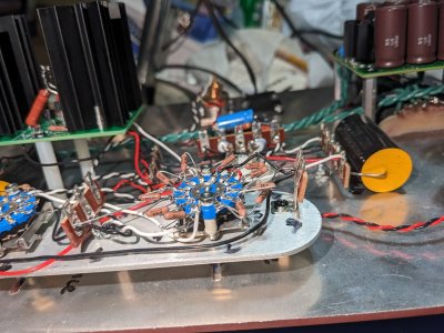

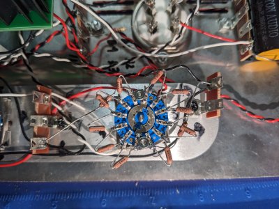

Hope these photos help

When I reviewed the photos I took I noticed that the white wire connected to the lower lug between 7 and 8 has kinda some abrasions on it. I think that was caused by yanking it out from the old volume control? If the wire is damaged from inside can that cause the problem as well?

Having a hard time finding the short circuit issue.  I trimmed most of the protruding wire, but still the same problem. Used a magnifying glass to see if Terminal 7 was in anyway touching the screw beside it and it did not show any part touching it. I measured the lower lug between terminal 7 and terminal 8 which also showed it was also 0. So I thought maybe this was causing it, Tried to remove the wire, but because I crimped it before I had a hard time removing it.  I just stopped and will ask a friend with better skills than me to remove it.
Just a quick observation, the lower lug is still stuck but almost out, I measured Terminal 7 again and somehow it became 5 Kohm, it was a sigh of relief.  Unfortunately after few minutes I measure Terminal 7 again and it is again at 0.  Not really sure what's causing the short.  I already turned the aluminum chassis upside down and tapped into it thinking maybe something stuck in between but nothing fell out. Terminal 8 to twelve also looks fine though.  Can it be a problem of other terminals?
