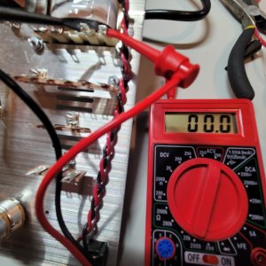

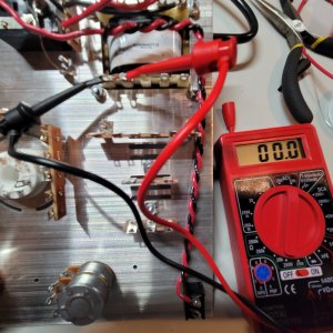

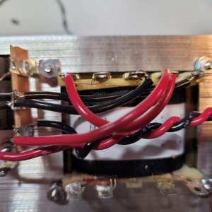

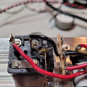

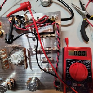

Got the transformer wired for 120V and I'm getting no voltage. 0V on xformer terminals 6/7 and 9/10. 0V on terminals L/N of the IEC but had 120.3V previously. I've retraced my wiring a few times to make sure everything goes to where it's supposed to be. Any ideas?

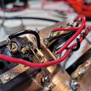

More pics

I would check to see if the fuse is blown.  You should still see the 120V at the L/N terminals of the IEC module. If the fuse is blown, replace it and let us know if it blows again and we can make some additional suggestions.  I don't see anything that looks amiss in your build so far.

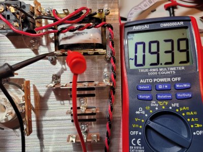

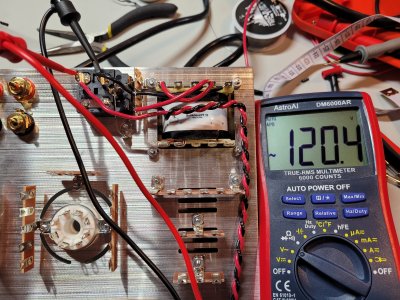

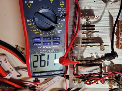

I appreciate the speedy responses Paul and Doc B. Checked the fuses and they all had continuity and had been installed in the clip of the fuse holder. I decided to get a better meter and that seems to have done the trick. I think I'm back in business. Could you confirm I've got this new meter on the correct setting?

Yes, that is the correct setting to measure AC voltage...John

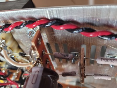

Ugh. My first point-to-point experience. Accidentally took some ceramic off a resistor using needle nose pliers to wrap wire around a terminal. Should I not sweat this and move on or should I replace the resistor?
    • Posts: 20294
Reply #10 on: December 18, 2022, 06:57:49 AM
Just double check that the resistor still measures properly with your meter.  If it does, you can leave that alone.
