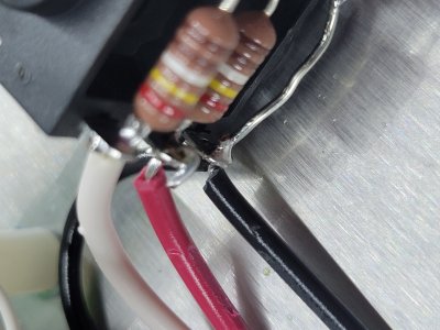

I sat down at my desk and when I grabbed my headphones there was a tiny static shock at the headphone jack and a loud pop that seemed to maybe come from the can and not the amp. Since then ive had no sound in my right ear despite swapping tubes. I checked my old schiit magni and all works as normal so the headphones are fine.

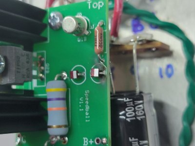

edit: found this scorched looking LED that definitely is not from initial solder work. Where could I find a replacement and how can I prevent this going forward? My floor is wood and I don't shuffle my feet lol. I use the provided cables with my dt1990s and stuff as well.

This is very, very often a loose black wire on the headphone jack not captured by solder.
Offline l33tsauce7
    • Posts: 12
Reply #2 on: December 16, 2022, 07:35:16 PM
All connections (on both ends) are solid as far as I can tell.
    • Posts: 20299
Reply #3 on: December 16, 2022, 07:37:17 PM
I would tug a bit on that lower wire to be sure it's well soldered.
Offline l33tsauce7
    • Posts: 12
Reply #4 on: December 16, 2022, 07:40:43 PM
Yep solid. I did edit my original post with a seemingly scorched LED incase you haven't seen that yet.

How are your DC voltages?
Offline l33tsauce7
    • Posts: 12
Reply #6 on: December 16, 2022, 07:44:47 PM
Across what points? please excuse my ignorance
ill check them all derp
« Last Edit: December 16, 2022, 07:46:26 PM by l33tsauce7 »
    • Posts: 20299
Reply #7 on: December 16, 2022, 07:46:32 PM
Pages 19 and 30 of the Speedball manual list the voltage checks for each board.
Offline l33tsauce7
    • Posts: 12
Reply #8 on: December 16, 2022, 08:01:28 PM

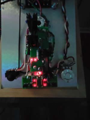

OB on the large board for the speed ball is reading 200 volts instead of the usual 85ish. also the LEDs are dead on that side now coinciding with the burn marks i found a little bit ago.
Offline l33tsauce7
    • Posts: 12
Reply #9 on: December 17, 2022, 02:39:38 AM
Went ahead and placed an order for a few replacement LEDs. Hopefully it's a simple swap and won't happen again
    • Posts: 20299
Reply #10 on: December 17, 2022, 10:22:37 AM
I would also replace the 2N2222 and TIP50 on that side of the board.  When all the parts are off, you can verify that the resistors measure properly without taking them off the board.
