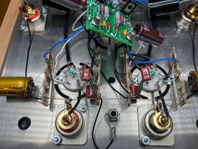

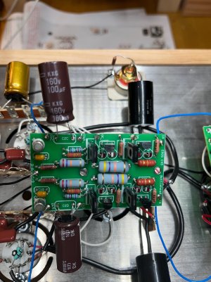

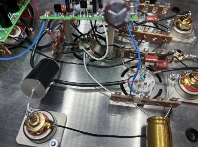

Do you have recommendations on what to focus in on?  I’ve attached a few pictures.

Something like the Q2C center leg not getting adequately heated could cause something like this.

Yes, after looking closer, the middle leg of Q2C didn’t have the solder flowing fully through.  I think I have resolved this but the voltages are measuring the same.

I would reheat the rest of the resistor and transistor joints on that front PC board.  The LEDs generally solder easily and don't require extra effort.

The lead on the 0 ohm resistor going through A3 was touching A4.  I resolved that and it brought OkC down a little bit to 5.2 volts but others didn’t change.  Would this issue have caused any damage to the tube?
