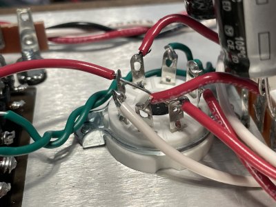

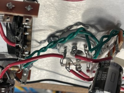

    • Posts: 22

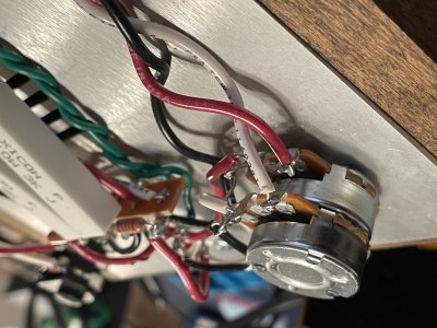

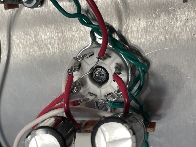

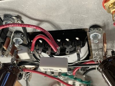

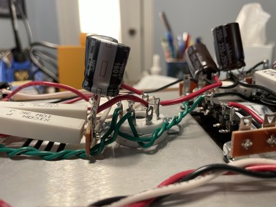

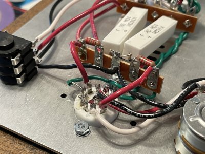

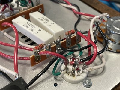

Oh, boy.  This is gonna hurt.  This is embarrassing (especially the burnt wire), but here it goes.  I want this fixed!  Man, those LED's were tough to maneuver.  Thanks for the help, btw.  And feel free to be blunt (I'll take solace in egg nog and knowing this is my first project.)
« Last Edit: December 23, 2022, 04:08:22 PM by Necplur »
    • Posts: 20297
If terminal 2 and terminal 4 don't show exactly the same voltage, then I would suspect that there's an issue with the wire that connects the two together.  Otherwise I don't see any reason in your build photos for that half of the 12AU7 to not draw any current.
Do also note that it's not your LED.  A damaged LED will fail open and allow more like 12V or so to appear at A3, but since you have 0V that's not the case.

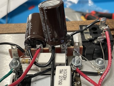

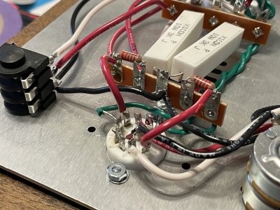

Are the 10W 3K resisters supposed to be so hot, being on only long enough to take voltage measurements?  (I'm a dummy, I shoulda known.. being in front of the vent!)

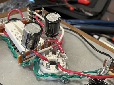

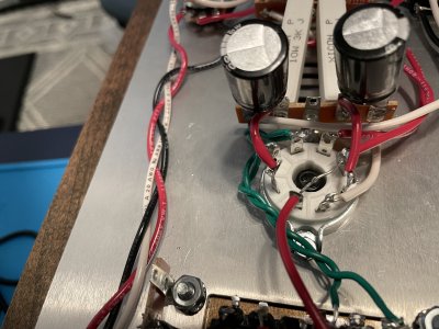

I re-did A4/A5 again.  I also replaced the wire between Terminal 1 and A6 (the burn was bothering me.)
Still no luck.

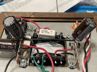

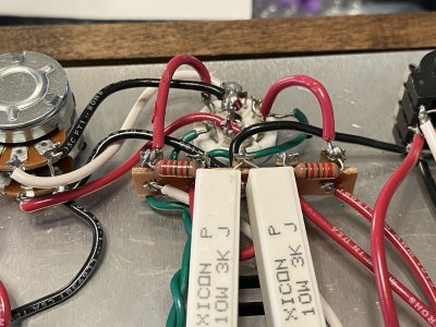

I included more pictures, in case any of them shed any light.  Also,

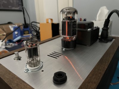

    • Posts: 20297
Do both halves of the 12AU7 glow?
Yes, the 3K/10W resistors get hot.  One of those resistors right now will be getting hotter than it's supposed to because you have an operational issue with your amplifier.
Offline Necplur
    • Posts: 22
Yes.  Front and rear dot on the top glow.

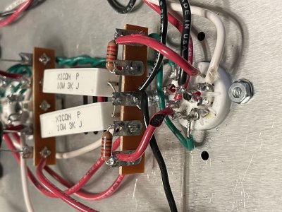

Offline Necplur
    • Posts: 22

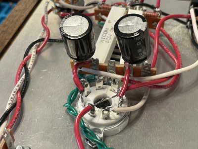

Here is a pic (sorry I didn't include it before, the forum was erroring out on posting.)
    • Posts: 20297
Can I see the octal socket wiring as well?

    • Posts: 20297
The soldering at 5L looks a bit suspect, but that shouldn't cause this issue.
What I would do is get a wooden chopstick and run the amp flipped over, then gently poke around the amp to see if you can put a little pressure on a specific connection to get that A3 LED to illuminate.
