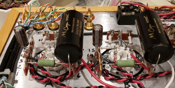

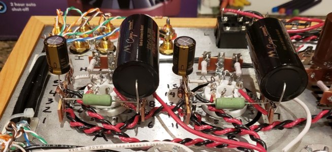

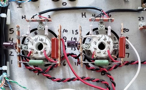

Reply #6 on: December 30, 2022, 10:13:08 AM
In all honesty, I think it's evident that parts selected for kits by the BH engineers are given careful thought and consideration from a performance standpoint. IMO, upgrading is totally unnecessary for excellent performance.
I personally selected the Mundorf's because they have a good reputation, were relatively inexpensive, and cosmetically look great. I also upgraded the small caps because of reputation and cost (very cheap).
My bias wants to think it's better. Is it really? I am not sure. It seemed the most noticeable change was with the small caps ?? What I do know is nothing is worse, my wallet weighs about the same, and I am very happy with the audio I am hearing. I attached a few photos showing the different small caps, one using upgraded Nichicon's, one using ELNA's, and one using stock.
« Last Edit: December 30, 2022, 02:35:43 PM by Mucker »
Offline steveau
    • Posts: 10
Reply #7 on: December 31, 2022, 02:01:14 AM
I see you went up to 220uF’s (from 150’s) to ground,
could that really account for any audible changes?
I’m curious, because I don’t have much audio electronic knowledge.
    • Posts: 20292
Reply #8 on: December 31, 2022, 05:45:40 AM
220uF is a far more common value but otherwise works about the same as 150uF.
