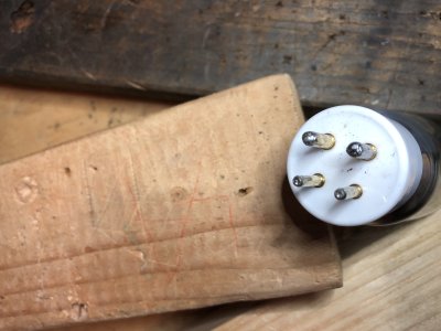

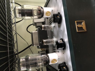

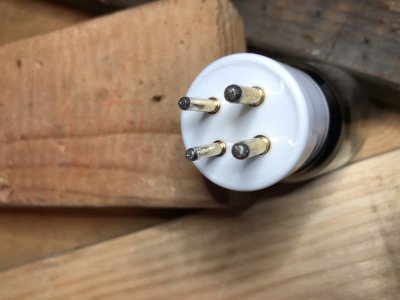

These are the stock 2A3 tubes on my Stereomour I bought in 2021, order 28291
In this picture, I tried switching tubes- the ones on the right work if I switch them to the  left, and conversely the ones on the left disable the right channel if I switch them to that side.
So from my switching, the right tubes work, the left do not.
From what I see in the forum, it's strange these tubes didn't last much longer. Please advise.

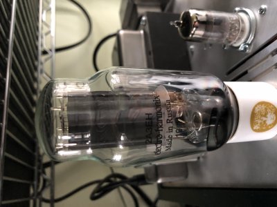

The 2A3 that is giving me issues is not glowing as you can see from this image
I assume this is a bad tube? Is there anything from my resistance or voltage results that could have caused this?
Trying to understand what happened that made a perfectly working system not, as these tubes should last longer...
