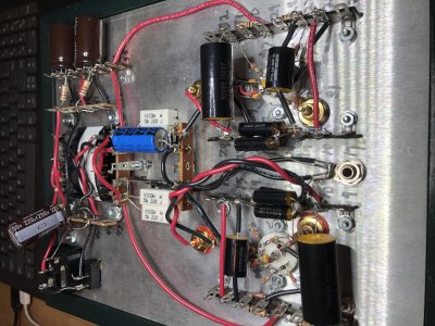

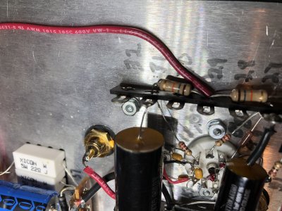

Hi just did a resistance test on my reduction, This was a previously working build that no longer does.
Everything was correct except terminal 23, which reads 0 resistance.
I assume I need a new 0.47 400V capacitor?
Online Paul Birkeland
    • Posts: 20295
Reply #1 on: January 08, 2023, 12:37:23 PM
If you remove the cap, do you still get 0 ohms of resistance at terminal 23? I am willing to bet that you will.
That cap could be a dead short on the inside and it won't give you a 0 ohm resistance there, but solder that has spilled over from the center pin of the output jack to the shell of the output jack will, and that's something that is pretty common to see.  Terminals 24 and 22 are also at ground potential, so if there is debris between 23 and either of these terminals, that will also provide an unwanted ground.

Update on this-- after fiddling with it, and doing some RTFM, I see the real problem was that there was no 475k ohm resistor from 22L and 23L
