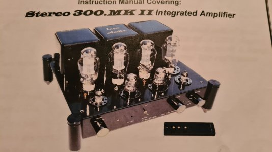

I think I have been misled on the info I have read because as you say my amp is a push-pull, sorry about that. It is the Stereo 300. MKI which has 4 x 300b, 2 x 6SN7 ans 2 x 12AT7's but it just seems to lack bass to my ears.
I'm wondering if I can find something better from your kits that would be better in the bass department?
I not sure what you mean by your 0db to 6db Paul, excuse my lack of knowledge 🤔.
I'll put a pic up of it if that OK.

The manufacturer mentioned an adjustable feedback switch.
Something like the Kaiju will have fuller bass (in my opinion at least) than a 300B push-pull circuit due to the lower damping and extra bit of harmonic distortion that distinguishes SET amps from PP amps.
