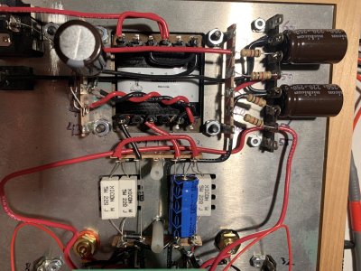

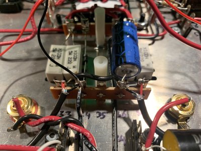

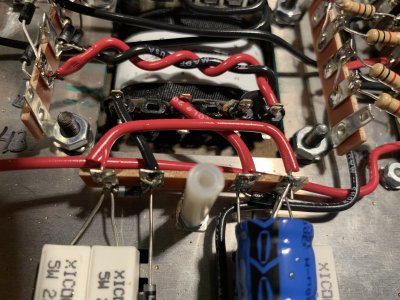

I've included some photos of the area with the Integration PCBs out of the way.
Any thoughts?

I would suggest turning the temperature of your iron up all the way and adding a little more solder to most of those joints.
Also when a lead passes through a terminal, it should at minimum be bent up 90 degrees against the terminal.  If the lead just passes straight through and isn't bent, things can come apart more easily and the solder has less to grab onto.

Had time to reflow all points around the power supply area.
I still measured the same wrong resistances on 38/42 and 39/41 but the distortion is gone and the amp sounds the way it did again.
Been playing now for 30mins or so and things seem stable
