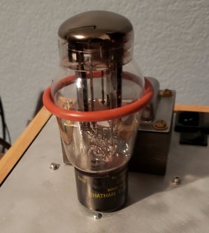

I have a 2399 tube that I use with my Crack (same shape as a 6AS7) and it has a high frequency vibration that makes the top plate of the amp ring. If I move the tube around slightly or tap on the plate I can alter the ringing, sometimes it disappears but eventually it will come back. What nearly eliminates it is using a tube damper ring (42-44mm for 6AS7 shape). The 2399 is a tube I really like so this solution works well.
I use RCA 6AS7 tubes in my Woo Audio WA2 (as well as Crack) and they all seem to vibrate/ring. The tube dampers help with those as well. I have never experienced ringing with 6080 or 7236 tubes. Anyway, I attached a pic of my 2399 with damper and a link to some dampers (44mm will work best).
