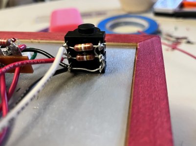

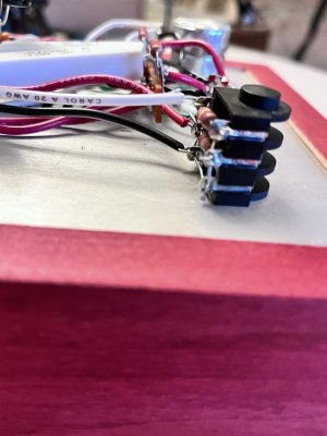

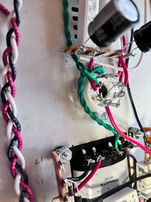

I would be interested in seeing some more photos of the headphone jack wiring.
Your DC voltages are where they are supposed to be, so this is most likely an issue with the wiring from the input jacks to the 9 pin socket, or possibly from the rear 5 lug terminal strip to the HP jack.

No problem
    • Posts: 20302
Reply #3 on: January 23, 2023, 03:01:24 PM
One of the black wires on that headphone jack isn't captured by solder.

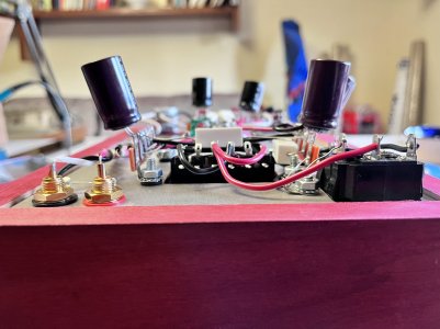

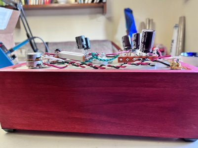

Nice, that solved my channel issue, although now listening carefully I hear some noise, like interference on a radio, could this be cause by a cable with an insulation burned off?
Maybe some of these two could be causing the problem

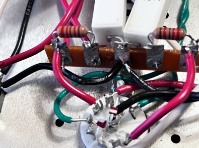

    • Posts: 20302
Reply #5 on: January 23, 2023, 04:29:21 PM
A6 is not soldered.
What are you using to feed the Crack?  If it's a PC or USB powered DAC, there's a modification stickied for that on the Crack part of the forum.  If you're not using a source that presents those issues, it could just be proximity to a WiFi or cellular device, and a few extra feet of space would make a big difference.
