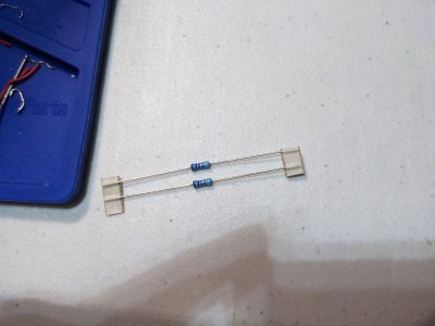

Finishing the output upgrade but the last resistor to be installed is a 412 ohm 1/8 watt.  From the PDF instruction manual the last  resistors to be installed are a Dale brown colored with number marking on it and to be soldered to 64L and 65L, the other one is 61L and 62L.  But the one left on the kit is a regular banded one. I checked the color code it is correct.  Do I install this or this is a wrong part? Attached here is the photo of the last two remaining resistors. If it is okay, they proceed to finish the project

If it is the correct value, it's the correct part.  These days things go in and out of stock like crazy at the electronics distributors, so we end up making substitutions here and there.
