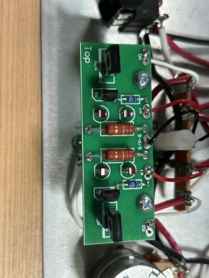

I was able to re-engineer the clipped resistors back into place successfully. I went backward in the steps and removed the 2nd (large) speedball board. At this step, I tested with the small board still integrated and found that audio was restored and working on both channels. Again, the sound is quite improved from the stock config.
Apparently, there's an issue with the large board. I have re-soldered it to no avail. I'm wondering if I cooked something in the initial assembly. I will include a pic for reference. I did flip the resistor in R2A since the pic to match the build guide.
The hum: There is a noticeable hum now with the stage 1 speedball. I wonder if it's related to the greater apparent gain? I'm running at 40% vs 65% at the same volume as stock with stage 1 installed. With music going, it's only noticeable on very quiet recordings. I also get an intermittent and loud shhhhh sound that comes and goes for a few seconds every several minutes.

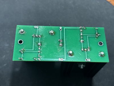

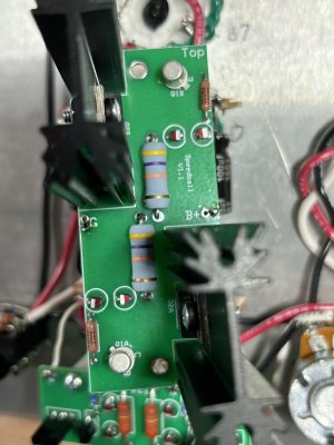

I can't see any of the solder joints on the big PC board.  Having a look at those could be helpful.
Offline cottonmouth
    • Posts: 11
Reply #9 on: February 27, 2023, 09:58:10 AM
Please let me know if you need any other shots. Thank You!
    • Posts: 20204
Reply #10 on: February 27, 2023, 10:40:44 AM
If your iron has a temperature adjustment, I would turn it all the way up.
