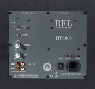

Image attached.

With the two prong power cord, I would not anticipate noise issues with a BeePre.

Reply #10 on: March 08, 2023, 06:34:11 AM
There are only two metal prongs in the IEC power inlet on the subwoofer plate amp, so the third prong just isn't used.

Interesting. I had a look at the manual online and it has a picture of this configuration with RCA cables from the preamp output to the sub low level input jacks. The output RCA jacks are for daisy chaining another sub so be sure you are connecting to the input jacks.
I agree with Paul that a splitter should work fine but to rule it out you could connect the preamp output to the RCA low level inputs of the sub. Turn up the crossover point and play some music. It won’t sound great but if you hear music without a hum the connection is working. If that works add the splitter at a the preamp but keep the only cable going to the sub. The other side of the splitter is empty. If that makes music that side of the splitter is good.  Then move the cable to the other side of the splitter and test.  Now you know both sides of the splitter are good and the sub is playing without hum.
Now add the amp connections on the empty sides of the splitter and see what happens…
