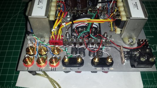

On my S3X I mounted a 4pdt switch by the inputs to select between 4 and 8 ohm transformer settings.
