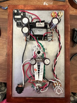

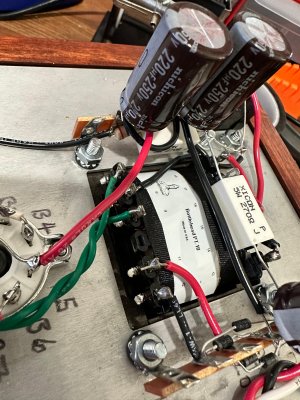

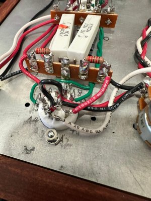

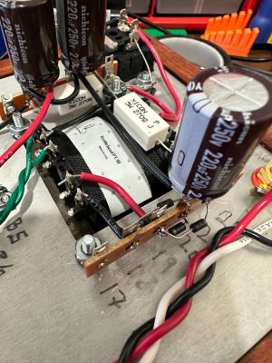

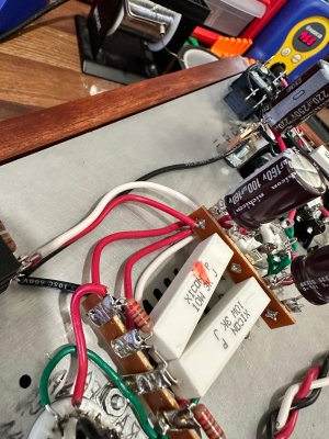

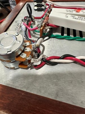

Hello,
Just wrapping up my Crack build (pre-speedball) and things went relatively smoothly. Resistance check passed (after relocating a wire I installed in the wrong terminal), but I ran into a couple of anomalies with the voltage check:
T01: 147 (expected 50-100)
T02: 162
T03: 0
T04: 162
T05: 75
T06: 0
T07: 147 (expected 50-100)
T08: 0
T09: 102
T10: 0
The LED between A3 and the 9-pin center pin lights, but the LED between A8 and the center pin does not. Likewise, the front portion of the 12AU7 tube glows but the rear portion does not. The 6080 tube glows as well. During the glow test, both portions of the 12AU7 were glowing. The amp outputs sound, but only from the left channel.
I dug around on these forums looking for similar issues but wasn't able to find anything that solved my problem. One of the suggested steps that I saw on here was to solder a jumper wire between A3 and A8, and when I did that, both LEDs lit up but voltage on 1 and 7 was still high. Unfortunately I also damaged the center->A8 LED. For now, I have the A3->A8 jumper in place until I can order a replacement LED.
I reflowed a variety of solder joints without any change to the voltage, and I've been over the docs a couple of times and can't see what I'm missing.
Has anyone experienced something like this before? I've attached pics and can provide additional angles.
