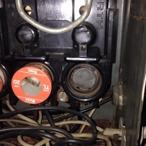

I am in the US. I desoldered everything back to voltage test one and tried with different outlets and found the outlets on one breaker put out 101.8v which would explain why electronics sometimes act wonky in my apartment. The rest of the outlets are at 123v and I will be rewiring for that voltage

... the outlets on one breaker put out 101.8v which would explain why electronics sometimes act wonky in my apartment. The rest of the outlets are at 123v ...
It would appear that there is a problem with that breaker; it may be dangerous. Something is dissipating 20 volts, turning the current into heat. If it were me, I would get that resolved as soon as practical.

Reply #4 on: April 02, 2023, 07:12:42 AM
Could be Lincoln?

Haha I didn't see any pennies lurking in the box. The breaker is now off and have a call into the building super. Glad this was gound before it became an issue. The Crack has been rewired and is now showing 6.8v & 178v
