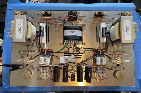

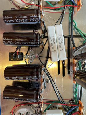

Didn’t see any rogue leads or debris in the area, but maybe something fell out when i flipped it back over. Images of the overall build and the area in question.
« Last Edit: April 24, 2023, 07:14:15 AM by Lowercase »
Reply #3 on: April 24, 2023, 07:30:22 AM
Things look pretty tidy in there, I would be inclined to think there was a tiny piece of debris that cooked itself away.

Reply #8 on: April 24, 2023, 11:41:21 AM
The white wires you have going to the rear terminal strips are not wired properly and will cause these issues.

Reply #9 on: April 24, 2023, 12:24:38 PM
It’s always good to be humbled from time to time! :) I think I stared at every connection for a good minute or two.
Fixed the error(s) and perfect measurements!
