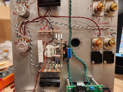

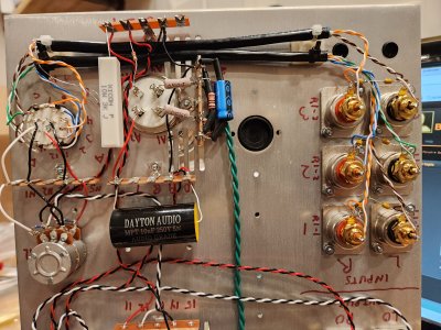

My BeePre-2 makes barely a whisper at full volume.  I tried it through my Stereomour and also feeding into my crack. (that sounds pretty bad)  The Stereomour and the Crack were at full volume.  I redid all resistance and voltage tests, and all pass.  I retraced all the wiring instructions and found no error.  I would appreciate any help or suggestions!

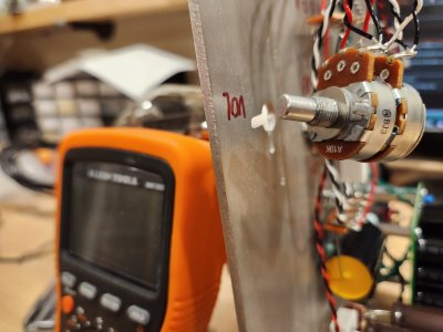

Can you double check that the correct pots are in the correct holes?
Can you post a link to the meter you have for your build?  If it's not something simple like a pot that's swapped, we'll need to have you play a 60Hz tone into the preamp to see where it's dropping out.

A10k in the volume position. Klein mm1000 multimeter

well, I must have jostled a flaky solder joint or something because it is working now with my quicksand.  I'll reflow and revive this thread if it quits working. I'm sorry to have wasted your time, but very grateful for your help!

I bet you have a black wire that's loose, as you mentioned that both channels were gone and some grounds are common between channels.
