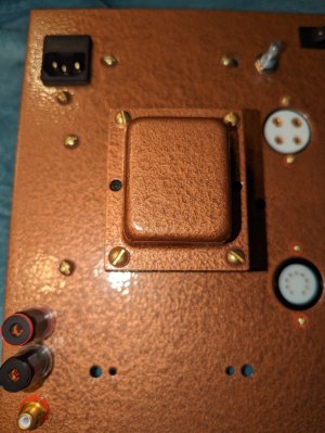

I like big caps and I cannot lie.
To provide them some extra breathing room I decided to go with some spare Paramount top plates. Sanded to a low polish, 2000 grit, then primed and painted Hammer tone copper.
Machined Teflon tube sockets.
Custom resin printed hole shrinker.
All brass hardware.

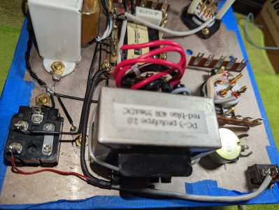

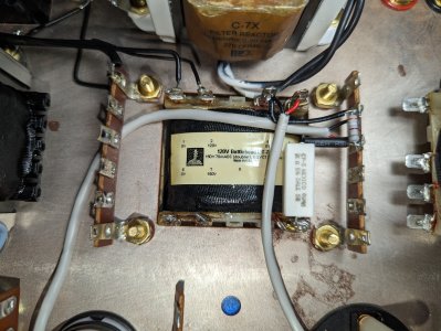

PT-7 power transformer.
Prototype OT-2 output transformer and PC-3 plate choke I traded PJ some OG PT-2s for.
NOS paper wound C-7X in Rust-Oleum white.
Underside of the resin hole shrinker.
Random unbranded RCA and binding posts I picked up at an electronics market in Seoul, Korea.

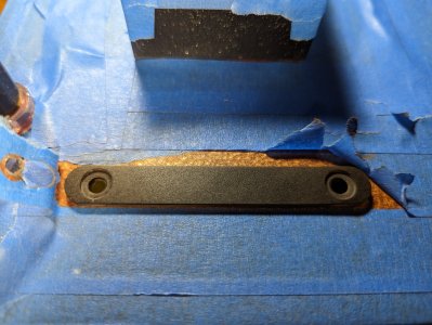

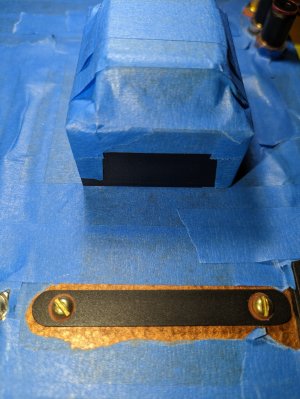

    • Posts: 386
Black resin printed hole drilling guides/standoffs to accommodate the OT-2 and PC-3 on the Paramount Chassis

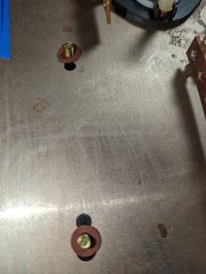

    • Posts: 386
Safety ground wiring.

Speaking of TX design and implementation.
PT-7 has marked 150v, 6.3v and 3.15v out with corresponding 0v for the 150v and 6.3v.
Need 300v and 2.5v.
First blush, just instal a voltage doubler for 300v. Or is there a better way here?
Drop the 3.15v to 2.5v with a voltage divider, no problem.
Where should I pull the 0V leg for that though?
    • Posts: 5907
Yes, the PT-3/7/10 uses doublers for high voltages. For lower voltages (such as Crack), the winding is used with a fullwave bridge.
In the MonAmour, the 6.3v center-tapped winding was rectified with the usual FWCT arrangement; it's OK to use half the winding to power a 2A3 or 45 with AC. Be aware that either arrangement biases the 6.3v terminals to the cathode voltage of the 2A3 or 45 - around 50-60 volts depending on the specific design. It's important that the winding be AC grounded because it also serves as an electrostatic shield for the high-voltage winding. Usually the cathode bypass cap provides the grounding function
Offline ssssly
    • Posts: 386
To make sure I understand you correctly, pin 4 is the center tap for the secondary and therefore common for both the 6.3v and 3.15v.
Normally those legs would be phase corrected with full wave bridge rectifiers but since both legs are being used as AC heaters, it's not necessary.
And the cathode bypass cap is sufficient for the ground path for AC shielding in that configuration for the otherwise standard SR45 circuit.
