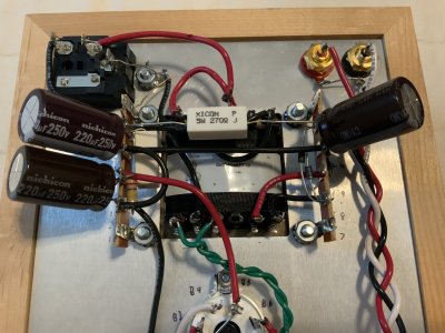

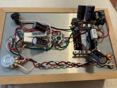

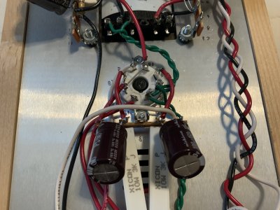

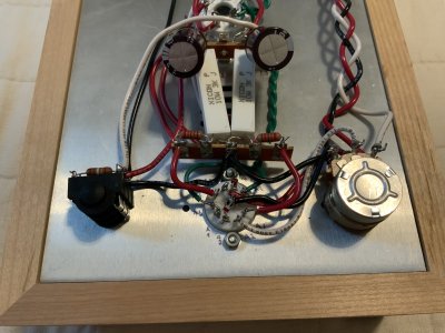

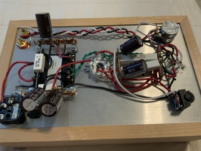

I’ve had my bottlehead crack for a while now, and noticed there’s a static sound on the right channel only.
I wiggled the 12au7 tube and it made a noise on the LEFT SIDE so I re-soldered the wires and it’s quiet when I wiggle it now, BUT. The static on the RIGHT SIDE still persists.
I’ve poked every wire with a chopsticks and fixed about 3 that made a noise when moved. But the right channel static still persists.
The right static is a constant volume. Whether the volume is off or max the statics volume does not change. I unplugged the rca cords and the static persists.
I’ve re-soldered other wires but it has gotten worse I think

The solder joints on terminals 7 and 9 may need a little more solder/heat.
If you rock either tube around while the noise is happening, does it change?
I reheated and added more solder to 7 and 9 but the noise still persists.
The static doesn’t change when I wiggle or move the tubes around it’s just a constant static noise on the right channel only

Reply #9 on: May 29, 2023, 04:51:54 PM
Update: Upgraded to the speedball last night and so far there is no static in the right channel (I hope!) , hopefully it's fixed. Not sure if it was from the parts I took out to install the speedball, or from soldering the terminals again while installing!
