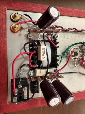

The amplifier had been working properly for a while but the amplifier doesn't produce any sound now, the resistance check is fine but the voltage check is not, I'll post both values and some pictures if those help.

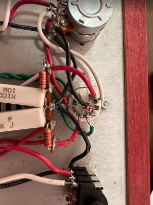

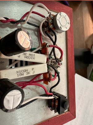

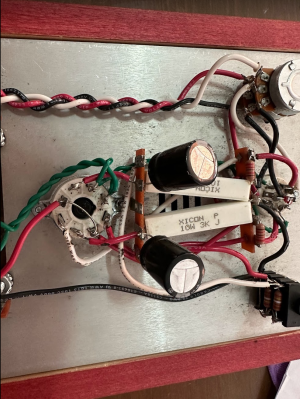

Reply #11 on: June 06, 2023, 08:07:24 AM
I would look for component leads that are touching or close to touching other leads or the chassis, as well as for loose connections.  I would not consider your amplifier fixed.
It's likely that if you run the amp and poke around with a wooden chopstick, you should be able to poke the problematic area and see the LEDs go out up front.
