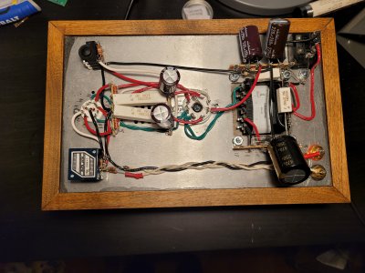

I put in a new capacitor at 12U & 13U, forgot to check the polarity and installed it backwards. It passed resistance checks but when I switched it on for the voltage test, it went from 75.2v to around 230v with a puff of smoke. Besides the capacitor, what other components possibly got fried? This is a Crack 1.1 no Speedball & resistances before voltage were basically the same except 22 & ground were 0.2 ohms. If more info is needed, please let me know. Thanks for the help!

The solder joint on 12L was partially wicked away from when I removed the cap. I resoldered at 12L and the headphone jack. It is still showing 230v but it is now blowing the fuses

Let me know if you need pictures of a specific section

There's likely to be some component leads or trimmed wire ends touching something they shouldn't on the octal socket, which is causing your amp to draw too much current from the power supply during operation.  I have seen this kind of problem from something like a backwards 100uF capacitor on the rear 5 lug strip, but I don't see any obvious issues with your amp from the picture you provided.
