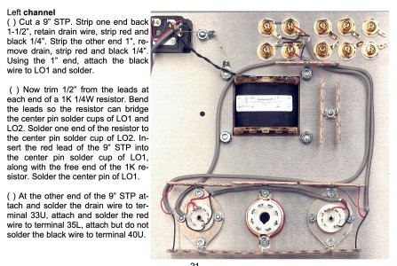

I was planning on adding a second output to my BeePre2 like I have it on my Foreplay 3extended. The Foreplay manual says to use a 1/4w 1kOhm resistor between the 2 outputs. I attached a photo from the manual to clarify.
I wanted to double check if this is the right way of doing it on the BeePre and if I should use the same resistor value. I would like to plug in my Crack while also playing through my speakers. I would also use the second output for recording just like I used to do with my Foreplay. Thanks for the help.

I would send the output of the selector switch to the extra set of output jacks to make a tape output.

Thanks Paul. If I wanted to have volume and balance control on that second output would the Foreplay method be okay?

You could do that, or just use a pair of RCA splitters at the outputs.
