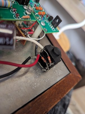

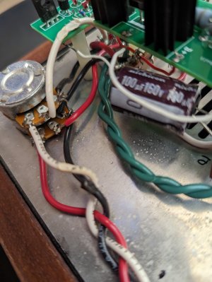

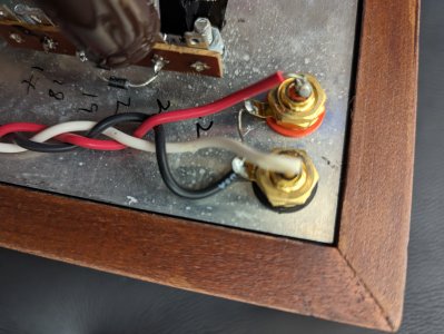

So I've had my crackhead with speedball for quite some time. Recently, the left channel has become noisy, especially when I or the headphone cables move. The left channel would make noises, or sometimes even go silent, from the smallest of movements.
Attached are a few build photos.
Thanks in advance.

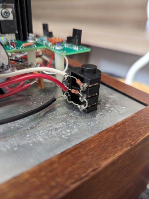

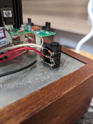

Could I see the wiring at your headphone jack?

Oops! I thought I uploaded the headphone jack wiring - sorry, will upload the correct photograph when I get home.  Appreciate the help!

Here are some photos.

The joint where the black wires meet may not be completely capturing both black wires.

Perfect, issue fixed! Thanks Paul!
