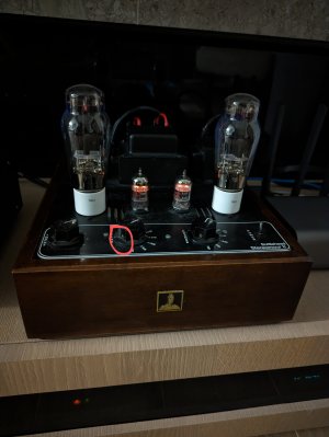

Does anyone know where to buy a replacement attenuator? The one for "fine" has now stopped working, as in I am no longer able to change steps. There are no more resistance when I try to move it. The coarse one still works fine...

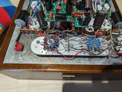

Paul... or anyone else... would you mind sharing the MourQuiet manual with me or show me how to fix the attenuator?  I can't seem to find my manual for the MourQuiet Attenuator.

So the issue is not that it won't move. It moves. But it doesn't have any "steps" if that makes any sense. I can rotate it but it doesn't click and the volume doesn't change.  If that makes any difference.

Have you tried tightening the set screw on the knob?

Is this the "set screw"? Sorry... I'm not familiar with the terminology...
Ben Chiou
    • Posts: 20281
Reply #7 on: June 13, 2023, 04:28:16 PM
That is correct.
Offline benzxc
    • Posts: 113
Reply #8 on: June 14, 2023, 07:59:28 AM
Ok that worked... Thanks Paul...
