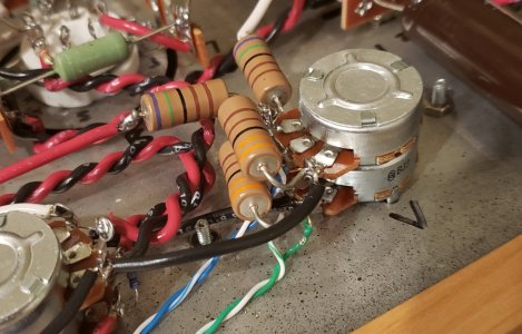

Just wanted to follow up and mention that after using those Harrison Lab attenuators, I wasn't happy with the sound of them, they just sounded a bit off for whatever reason. And I did try them in different positions.
I read an old post where it was suggested to pad the volume pot using 7.5 and 3.3 kohm resistors. I initially tried with some 1/2W I had on hand. I did have the 7.5 but no 3.3 so ended up with 3 resistors in series to get to 3.3. The result was excellent and I managed to get a much better range of travel on the knob and more importantly the audio was excellent.
So, I then ordered some 2W TKD resistors (less than $10 total) for permanent duty. Yes indeed they are overkill but I do like the meaty look of them. I laughed out loud when they arrived, I didn't realize they were that big.  :-* I also recently installed Jantzen caps and NOS Sylvania 6V6GTY tubes and the Moreplay has never sounded better. It is stellar!

Yes, it is the exact way, only the resistor values are different. With Moreplay it's 7.5K and 3.3K on the stock pot. Paul showed what to use in this thread:
