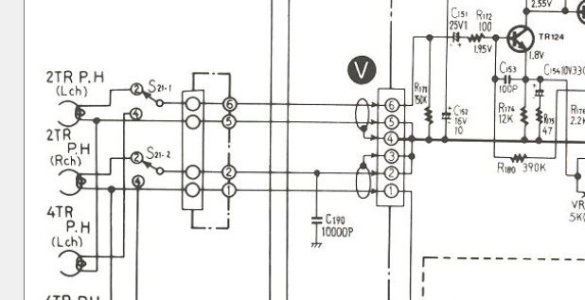

It's a Technics RS1500. Theres's one cable from the headblock switch to the playback amp. It's terminated with a four pin plug (female) at the head switch end and six pin plug (female) at the playback amp board end. The six-pin plug and the connection point on the board are labelled "V".
I thought I could just make an RCA cable with a male six-pin plug at the other end, and plug that into the female V connector on the cable coming from the head switch.  Then I could have a cable that can be unplugged easily: in particular, I wanted to test the setup first and be able to return to the original wiring if it didn't work out.
I have a photo of the plug I made, which I can post, but it'll be a day or two before I transfer it off my camera. I may have mis-soldered this plug, but as I understood it, I would need to connect a twisted length of the shield braid of the cable to the outer two pins on left and right (four pins total) to match the grounding shown in the schematic. Therefore I soldered the braid so that it crossed the outer pin to terminate on the next inward pin, and was soldered onto both. In other words, pins 5 and 6 are shorted together, and pins 1 and 2 are shorted together. 3 and 4 are the + pins for the left and right channel.
But it may be that I've read the pinout wrong, and shorted + to - ?

Sounds like you did it right, but I have not attempted a mod like you are describing. We would simply cut the six pin connector off the end of the internal cables and reconnect them to some RCA jacks mounted on the back of the deck. I'm afraid I don't recall if we connected the shield to the signal cold at that point (we were doing this stuff about 10 or 12 years ago), but probably we did. My hunch would be that you might need to ground the chassis of the preamp to the chassis of the tape deck to kill the hum. But if you are not getting music signal there might be some other issue like a shorted hot signal leg.  First thing I would check is if the shield is actually disconnected from the signal cold when the internal six pin plug is not connected to anything.
