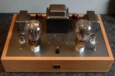

In November last year I built my first Bottlehead, the Kaiju. Before continuing I would like, as so many others have done, to congratulate Bottlehead on the excellence of their construction manuals!
Unfortunately my first impressions were disappointing with, amongst other things, a poor unfocussed sound stage, weak basses and sharp grainy highs. I have a lot of experience in trouble shooting and started, by a process of elimination, to hopefully pinpoint what was going wrong. It was a long process, taking 6 months in all and, just when I was about to give up, the solution came just a week ago.... as a complete surprise!!
So last week I happened to notice that my favorite tube supplier were offering a small batch of NOS RCA 5670’s at a very reasonable price. So I ordered a pair, installed them, switched on and started playing one of my favorite albums.
The Kaiju was totally transformed! After all that time I was finally listening to a very sweet sounding amplifier, with an perfectly natural balance and sound stage, really strong but taut bass and smooth extended highs. Just what the Doc(tor) ordered!
Sadly I have to conclude that one or both of the stock GEC tubes were in some way defect or became defect after the initial turn-on. How is this possible?
Any thoughts on this would be welcome!

Thankyou Paul, I have found the page in question and I did adjust the voltage as specified (I check off every step).
 Before going further, I made a visual inspection of the suspect tube(s) and found the pins to be very discolored/tarnished black/blue. I cleaned them with a mini buffer wheel and jewellers rouge and plugged them in. Hey Presto! The problems described have now been totally resolved.
Unfortunately I also had an even worse problem with the driver tubes of the Stereomour I built for a friend. These had corroded/bent pins and were totally unusable. They had to be replaced.
It seems like there might be a Quality Control issue here.
